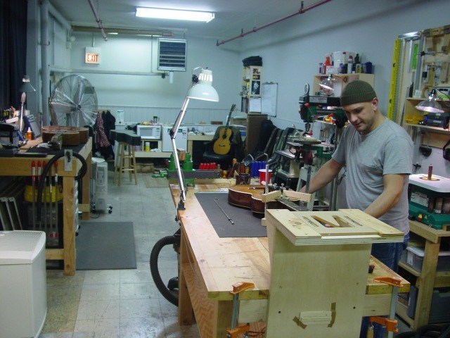

You all may be aware that Frankie Montuoro recently joined the OLF, and has already made contributions to the forum. Tonight I visited Frankie Montuoro at his shop to get a peek at his work and hear the thoughts of a truly fine luthier and craftsperson. What I found was a thoughtful and warm person, with a deep love for the instruments which have contributed to make the acoustic guitar one of the most beloved and versatile musical instruments ever conceived. Frankie was happy to share his knowledge and offer support for my first build. Frankie works in a nondescript building in one of Chicago's many old neighborhoods and while he specializes in restoring the famous Larson Bros. instruments, I saw other instruments as well as talked about the custom, one-at-a-time gems he builds. Thank you Frankie for your generosity! Can't wait to see more of your work and hear your guitars!

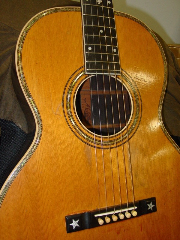

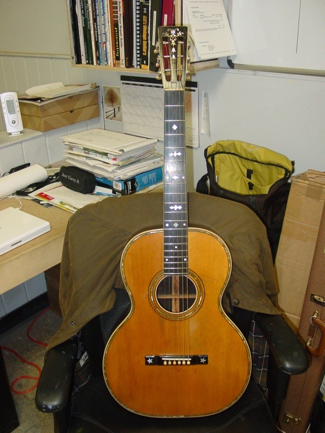

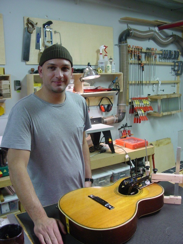

The guitar that is on the bench is a 1931 Larson Bros. Prairie State. The
Prairie State line of guitars are known for the Steel Rods that run the full
length of the body. You can see one of them through the soundhole. The
other was removed for the neck reset. But will be re-attached. As well as
the ( most often ) very shallow bodies. They used these rods in an effort
to build guitars with very thin materials. These guitars tend too have a
very, very punchy and treble heavy tone. And it sounds like the guitar is
amplified. It actually does. But it sure makes it hard to fix a loose brace
with the rods in place. I have never come across one that actually had a
loose brace. Thank God!!
The Top Raidus is 10' and the back Radius is 12'. These are pretty
common for the Bros. As well as being Built Under Tension. And from end
to end its depth is 2.5" to 3.25". Pretty shallow. But not for the Bros.

The Larson on the bench is basically an OM. Although many characteristics
of Larson's can make it difficult to tell really what it is.
I have seen some Prairie State copies around if you will. But just calling it a
Prairie State doesn't make it the same animal. There is a huge world of
difference between Larson made guitars and their counterparts for the time.
Where as an actual OM is much more documented and easier to replicate. To
a degree of course. And just measuring one wont ever give you a clear idea.
They were consistently inconsistent un-like Martin etc. And like many great
builders they used the materials on hand to the best of their ability.
